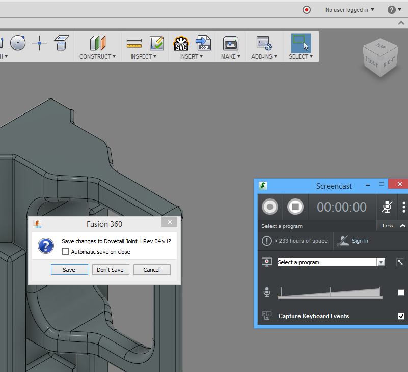

Sometimes I need to signout then back in before screencasts upload properly, when I tried this today screencast signed me out of Fusion as well. I tested this a couple of times, this doesn't seem right.
Also when I sign back in I get this message and I have to close and restart Fusion and lose any unsaved work.

Here's another odd problem, when I'm signed out by screencast the signin menu is greyed out and clicking does nothing, the only way to sign in is to use screencast, signing in in screencast signs Fusion back in. It seem like the 2 apps are linked somehow!

Phil.E
This is by design.
Logging into Screencast or Fusion 360 will log you into the other. Logging out of Screencast or Fusion 360 logs you out of the other.

HughesTooling
@Phil.E It's rather unfriendly that screencast signs you out of Fusion and leaves you no way of saving your work though. If you sign out of screencast  you get this dialog asking if you want to save but by this point you're signed out.
If you click save you get this save dialog but you can't save because the cloud library is signed out and closed.

Phil.E
This is being discussed right now, thanks for the feedback. I just tested that workflow and got the same results.
