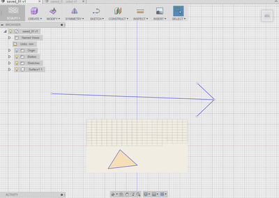

I receive an .dwg file with sketch and meshbody from AutoCAD. But when I open it with Fusion the scale of meshbody is incorrect. After some research I saw that if objects are grouped into block, the scale of meshbody is incorrect. But without block it's correct. The screenshots are attached.
Also I can send these .dwg files if necessary.
Could you please suggest any solution?
With block:
Without block:

So sorry for the delay here! You are not disturbing at all! I can reproduce the behavior and have created report (FUS-19811) so that development will investigate the issue further for possible cause and resolution.
I can tell you that these files were not created natively in AutoCAD. You receive a warning about this when opening the files in AutoCAD. However, AutoCAD does appear to read them to be the same size (exploded and un-exploded). As soon as I hear anything, I'll be sure to post back here.
Can I ask what you are hoping to accomplish in Fusion 360? Perhaps, I can help to guide you around this issue?
