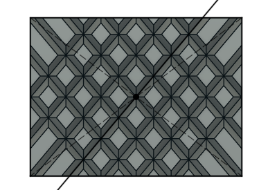

  I am designing a part that sits on the floor /ground. Of course PLA, especially if the print is nice, is rather slick. So I want to add knurl marks or slots to help prevent it from sliding. I have watched video tutorials..... but it seems like a lot of work.
  Since the bottom of my part is a rectangle....  can I get a drawing, or something "stock" that can be scaled.... and somehow project it onto the rectangle plane /surface, and then extrude to make the knurl or groove marks?

Knurls are very simple to model, especially on flat surfaces.  Simply draw a line at an angle across the surface. Use the triangular pipe command to create one side of a knurl. Mirror it. Pattern those two features.

I wish it were that easy...... 10 minutes later..... couldn't get it to work
I drew a construction line 1/2 way through my plane /surface.....  but can't get the triangle pipe feature to mirror.....
what if I could just project and image onto the plane /surface and extrude to cut it
I just need SIMPLE

Look closely at the second image.  You will see the plane that is normal to the surface is selected as the mirror plane.

Are all of your sketches fully defined (no blue curves or white dots)?
