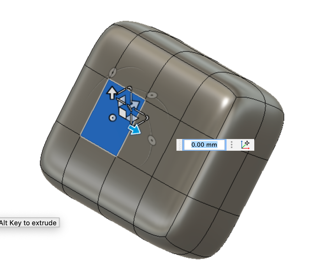

Dear Sirs,
I noticed that if I move a component and then create a shape the pivot point of the modeling environment gets stuck on the original position and there is no way to position it correctly. Is there any way to fix this?

Thanks for the answer, attached a screencast where I try to show the point where I encounter difficulties

for example I may need to scale a selection of points relative to that chosen origin. In short, I believe that it is essential for modeling a shape.

The problem is that I know how to lock the pivot point in place (click the red flag) but as you can see from the video it is displaced.
Message 11 of 14
laughingcreek
I was able to reproduce the behaviour from watching your video.  I think it's a bug. @jeff_strater ?

I can reproduce it as well.  Thanks for reporting it, @stefano.pedemonte - I will create a Fusion bug for this.
[edit] I created bug FUS-118831 for this issue.
Also, this problem is not limited to just Set Pivot.  If you rotate the component, you can see that the placement of the move triad in Edit Form is also wrong, so the problem is even bigger than that:
