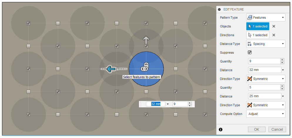

I am having some issues when I try to suppress occurrences in my pattern:
1. the arrows to adjust the spacing hide 2 of the suppression checkboxes. I could get them unchecked in the end but it took me some time to find the exact right spot on where to click. See the screenshot below.
2. When I select the pattern in the timeline later to modify it all checkboxes are checked again. I am not quite sure if this has always been this way since I use patterns quite often, but maybe I never modified a suppressed pattern.
3. Is there an out of the box way of creating a staggered pattern, apart from patterning 2 already staggered features?

I am working with suppressions again and I would like to bump this thread. The problems still exist.
.) Pattern controls covering the suppression checkbox
.) Suppression checkboxes are all reset when you edit the pattern again. Has been logged as bug FUS-43527 in 09-2018
Any news on these issues?

@tergu wrote:
...and the other screencast to hinder the suppression checkboxes.
This can be avoided in this way: > change to Extent
The other error (resetting the settings) does not occur with me.
günther
OS:  WIN 10
Message 18 of 23
tergu
...like Peter said, details matter.
Thanks to the idea of Günther regarding the checkboxes I think I figured out the problem. Could someone please follow the exact same steps I used in my screencast to verify?
It seems like if I use "spacing" to create a pattern it will not retain the suppression properties. If I use "extent" it will, even if I change it to spacing afterwards and modify the parameters.
Cheers,
Christian.
