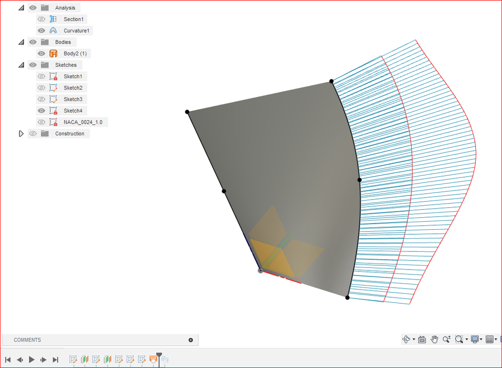

I have attached here the leading edge of the sail. As you can see, the result looks good even thought the comb analysis tool isn't happy. What do you think ?

davebYYPCU
For a curve comb to cross the curve like that I would not be trusting the chord length data, if no typos.
As a person with zero knowledge of the CFD stuff, I can't advise on that.
For Fusion, you can get an excellent 2 point spine curve to match the majority of those chord lines.  Least amount of spline points the better the result.
See mine.
Might help...

davebYYPCU
Generally, you have done what is described as required,
In the previous file, the chord length data was not as accurate as Fusion can work to.
If it were me, I would not need the trailing edge curve, I would be lofting the chord lines and let Fusion apply the curve for the Sweep guide rail.  (on average Body edges are higher quality over sketches)
Surface Loft (3 chord lines and no rails) comb is better than sketch curve comb, less work.
Might help....

TrippyLighting
@davebYYPCU wrote:
Don’t know why, @TrippyLighting knows why, will let him explain it, I just know from his lead.
Might help…..
I don't know implementation specifics, but I an say that the code that generates:
  • Sketch Intersection curves
  • Projections from curved  edges or curves into sketch planes that are not co-planar to the original curve/edge
  • Splines offset with the sketch offset tool
 creates sketch curves with curvature problems.
Those same problems do not exist when the edges of trimmed surfaces are used for modeling.
Generally I move away from sketches as soon as possible in any CAD software.

So I have made the wing, and I ended up simply accepting the fact that the spline has a terrible curvature. For some reason, I cannot do a sweep where both rails are made up of separate lines. Maybe I could sweep several times (I don't mind the fact it then has edges)...
The issue I have now is creating the winglet. I don't really understand why when I use offset face, the new face is not flat (parallel to the ground). This has been creating issues trying to create the guide rails. After some messing about, I finally got some sketches done and although in sketch 17 there is coincidence constraint, the tool says that the rails do not touch the surface. And actually, if you zoom in really close, you will see that the coincidence constraint seems to not work (even in the sketch where it was applied). Not sure what happened there...
Bottom line, what have I done wrong here ? And mainly, is there a way so that the sweeping tool keeps the surface flat (parallel to the ground) ?
I am happy with the sail other than I think I will redo it with multiple sweeps rather than using the spline. Will that maybe solve my winglet issues ? And for information, c0w is the chord at the bottom of the winglet (dependent value). c1w is at the end of the bend and c2w is at the tip of the winglet. All parameters needed are already in the file.

laughingcreek
@giulianoj.zennaro wrote:... and although in sketch 17 there is coincidence constraint, the tool says that the rails do not touch the surface. And actually, if you zoom in really close, you will see that the coincidence constraint seems to not work (even in the sketch where it was applied). Not sure what happened there...
that particular problem isn't with sketch 17.  the rail causing the problem is sketch 18, which you use as the guide rail for the sweep.  it doesn't originate on the surface your using for the sweep profile. which means at the other end of the sweep, the guide rail won't be on the surface either.  then you use the endpoint of the sweep guide rail to attach the end of the loft guide rail.   thus the "rails don't intersect all profiles" error.
...For some reason, I cannot do a sweep where both rails are made up of separate lines....
haven't looked at your model further, but this can generally be done if the path is valid.
FYI-you can't :zoom way in" to check if things are actually coincident. past a certain point of zoom, you'll get graphic artifacts, and somethings that are actually coincident will appear to be separated.  to double check things like this, yo can zoom in a bit, and then use the measure tool to see if there is any distance between the points. (ref pic above)
