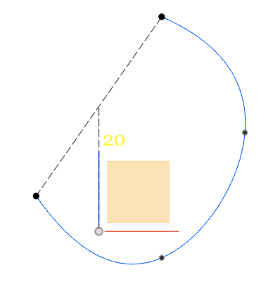

Question about splines. Let's say I've got this project (I've also attached it):
There are two sketches. Sketch #1 is the vertical line (height 20) and the diagonal line. Sketch #2 is a spline, with the start and end points projected from sketch #1.
I want to be able to adjust the height and have the spline keep its shape and move up or down. For example, here's height = 40:
The problem is, if I use coincident constraints on the ends of the spline, I get a stretched out shape like this when I change the height:
And if I don't use coincident constraints, I get this:
...which could then be fixed with a point-to-point move, but that's a pain in the ass if I'm changing the height frequently.
You might say, why not fully constrain the spline like this:
The answer is, that would be fine for this (simplified for demo purposes) project, but what I'm actually working on is a complicated spline with many points. I'd really rather not have to fully constrain each point manually.
Is there a solution? If there isn't, I think this would be a really useful option in a lot of situations.

@edgemarston - this is a good question, and well-described.  The short answer is no, unfortunately.  You describe the options pretty well as they exist today.  You can either fully constrain the spline within itself, with lots of dimensions, or you can use the Move command, and select the spline and anything connected to it.
The idea of a "rigid spline" is an interesting one.  "Fixed" doesn't work, because that fixes it in space, so we'd need to add a new concept.  Splines are the only curves with this problem, really, because everything else can be easily made "rigid" (circle with a diameter dimension, ellipse with major and minor dimensions, etc).
I'll run it by the team.  It's not a request we've heard all that often, to be honest.  If one were really ambitious, they could write an API script to self-dimension a spline so that it is effectively rigid, I suppose.  Though, once you have tangent handles visible, that task becomes harder.

Thanks Jeff! You're exactly right that what I'm looking for is a rigid spline option. The idea is that a model will often have one area that's more mechanical/parametric, and one area that's more artistic/organic. The endpoints of the spline are the transition between those two areas. The rest of the spline will then be used for a loft or extrude or whatever, to create a more organic shape. I'll want to keep messing with the parametric side (changing dimensions, etc.), but without having it affect the organic side.

I just realized that there is another approach here.  If you can separate out the "rigid" parts into another sketch, then you can put that sketch into its own component, and use Joints to position the entire component.  I have heard of folks using that method to rigidly transform sketches.  If you need to have it all combined into one sketch, then it's a bit more messy, because you would have to segregate the spline into its own sketch and owning component, then Project the spline into another sketch, to which you could add the other elements.  It all should hold together pretty well, but is a bit of a pain to set up.

Instead of scaling a spline, extrude a surface from it and then scale that surface.

@jeff_strater I played around more with your joint idea, and it actually led me to one that works even better. I was able to get the desired outcome by:
1) creating an extra sketch (a "floating" copy of the existing sketch that had been anchoring the spline with projections)
2) pointing everything that had previously been built off the old sketch to the floating one instead
3) using the align function set to bodies
This way I avoided having to make a new subcomponent or a joint.

You can actually extrude the spline into a surface and then scale that surface, thus preserving  the proportions of the spline. You can reference the edge of that surface just as you can with a spline. This does not work with 3D spines however.

Okay I see what you mean now. That's a neat trick. I got it working by extruding all the sketch elements into surfaces, then doing a move/copy on the extruded surfaces (rather than a scale, since I'm trying to keep the shape the same as before). Then I created a new sketch and projected all the translated surfaces back to the sketch, and then cleaned up by getting rid of the surfaces and re-referencing everything later in the timeline to the new sketch -- which is essentially a translated copy of the old sketch. It works.
The reason I made a new sketch instead of just using the surface edges is because I was having trouble referencing certain important points, for example the center of the crosshairs of an extruded ellipse.
More effort than ideal, but maybe better than the align-bodies method. Definitely useful to know about. Thanks!
