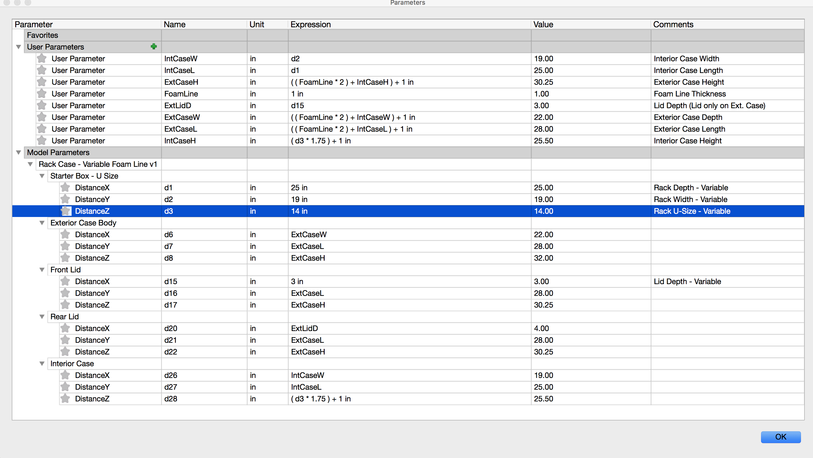

Hello All!
I have attached the f3d file below of which I am about to speak.
It is a confusing file (sorry) but I can't seem to get my prameters to update correctly.
What this is is a wooden box case. There is an interior box. Then there is a variable thickness foam lining and an exterior box, with removable front and rear lids.
My eventual plan is to make a sketch using the parameters defined in the file in order to extrude the wood peices to cut the box. Then, I can change the foam line and case dims to quickly create different sized boxes.
Primitive "RackCase" (dims d1 d2 and d3) are the big "controlling" dims on this project.
Primitive "ExteriorCaseBody" is the outside case.
Primitive "InteriorCaseBody" is the inside case.
Primitives "FrontLid" and "RearLid" are, of course, the front and rear lid.
I want RackCase to define the dimensions of everything. FrontLid depth defines the lid depth.
FoamLine needs to be a variable.
FrontLid and RearLid need to have the height and width of the ExtCase body so they can fit on ExtCase.
However, it doesn't seem like my parameters update correctly when I change them.
See the attached screenshot as well. ExtCaseH has three different values (see d8 vs d22).
What did I do wrong? Should I have my variables in a different order?
Compute All doesn't fix it either.
Any help would be greatly appreciated. Thanks so much!

So, it seems to be related to the order in which I had created them. I am trying to clean that up and I ran across the error mesage attached.
It says I can't delete the parameter becasue it is in use in an empty parameter? I have seen this before, but usually when I am trying to delete a parameter in use. The ones marked Old are no longer in use anywhere.
I have attached the updated f3d file as well.
I have tried looking at the parameter help, but it seems pretty scarce.
Thanks for any help!

Well now things are crazy. I think i have to start over with a new file.
See attached error - it says "FoamLine" isn't a variable when it clearly is....It's the second in the list...
I'm so confused haha 🙂
Message 6 of 28
Sorry for the multiple replies....
I have attached a screenshot showing some weird behavior I have in this file.
Also the most recent version of this file for comparison.
I have thee parameters that are broken. One is the first in the list - "ExtCaseH" Even when deleted, it reappears in the dialog once closed and reopened.
The others are named "FoamLine". These can match names (a big no no, I understand) and I can't delete either one.
Thanks!

Hi @Anonymous.  I think your original problem, in the first version of the design, is a bug in Fusion.  The order of creation of parameters should not matter.  I can clearly see that some of the values that reference "ExtCaseH" in this design are not correctly updating when one of the "upstream" values is changed.  They should always update correctly.  I will file this bug.  Good catch!
Jeff

 I think I can explain the appearance in the dialog after delete.
If you delete a parameter that is referenced by another parameter, we keep it around, because to do otherwise would break the referencing parameter.  I need to investigate further, but I think this is expected.
Jeff

I made an easy design (Attached and named "Simple") that is three squares - each is the previous square +1 in. Even in this simple file, the parameters simply aren't updating correctly.
Just asking, in the update news for this recent update, there is a note that says :
"Amcfarlen reported this issue where Fusion 360 would take forever to compute when using equations and custom expressions to define geometry in the parameters table. After some math tutoring, Fusion now takes < 1 second to calculate."
Is fusion "giving up" before it's done calculating, do you think? So that all the parameters aren't updating? Or am I reading too much into this?
James and I noticed that, sometimes, alternating entries, it seemed like the parameters were "keeping" the old values. For example, if you enter 5, the bodies don't update. but if you enter 3, the bodies update as if 5 were entered. You can see this in all three designs I have attached, but it is easiest to see in "Simple". Enter 1,2,3 in the first body - and it may not update to the other bodies. Enter it again, and they will update.
This same behavior also occurs on my "RemLid" file, in the sketch parameters. Editing it, and choosing any value other than the parameter name, then going back to the parameter name, will cause it to update correctly.
All in all, this seems pretty crazy, and I hope for a quick fix. Thanks so much!

Here's what we know so far (which unfortunately is not much):
  1. yes, this is a Fusion bug
  2. we haven't found the actual bug, but your analysis is actually quite accurate.  It looks like the equation system just stops early for some unknown reason.
  3. I could not easily reproduce it in a simpler case.
  4. there is nothing that I can see that is bad, or even all that complex, in your parameter set that should cause a problem
We will look into this ASAP, unfortunately that means Monday at the earliest, even for some advice about how to avoid this, or work around it.
Wish I had better news for you.

It seems the easiest workaround I have found is to enter the same value multiple times when inserting a numerical value. It seems to work when the same value is inputted several times, probably because it is "faster" to check if a value is the same and move on than to change it. So, after putting in the same value many times, you can work through a long chain of dimension changes.
If it is a variable name (like "Dimension") it only updates if I change it to something else (like "4") then back to the variable name.
For now, these are sufficient band-aids until a true fix comes through. I just have to be very vigilant and double-check the dimensions/calculations.

We have found the bug that was introduced in the Mar 30 update, and have a fix that we are testing currently.  We hope to have an update very soon for this problem.  I apologize for this this disruption to your designs.
Jeff
