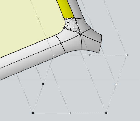

Yep, now that we have a model to get a hold of this looks a little different.
The code that projects sketch element into the new sketch creates segments that are not recognized by the other code (that is supposed to detect a chain), as a chain.
This is still far from robust. If you try to do this from stitched surfaces you'll have the same problem.
I am wondering if some of this has to do with the rather small overall scale of the model.
The bounding box of the main body is just this:
Message 8 of 13
TrippyLighting
Actually when trying to offset the projected profile I can elect one chain or the other, but I cannot set both. The purple points pointed at by the red arrows are also bigger than the green arrowed dots. That's exactly where each chain ends.
I tried to re-create this in another model but was not able to. The code that reduces the radii to sharp edges when the offset gets too small worked there.

regarding the sketch project edge issue I am close to say this is a sketch engine issue only as all my geometry checks worked in Fusion as well as external apps.
stitching works till a very precise level
quite funny is how the STEP export is done for the G1 fillet. This are trimmed tubes !!!
Just G2 fillets are blend surfaces
but the sketch issue happens with both G1 and G2 fillets!
piping the trimmed face works well.
piping the projected sketch does not
piping the secondary surfaces works well.

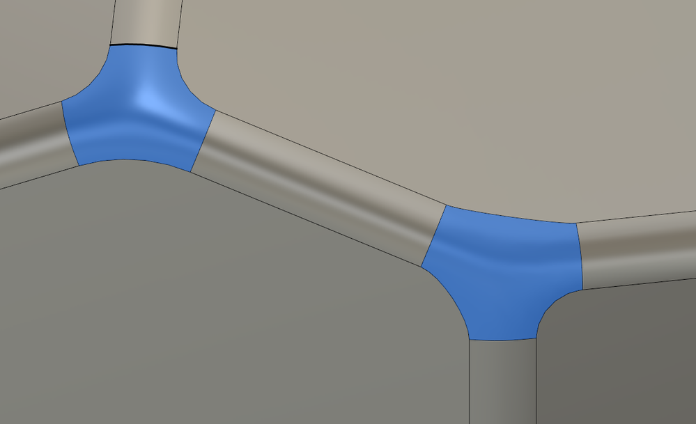

on a side note this models shows some pretty ugly fillet ball corner design.
the left fillet looks fine while the right fillet in 2 of 3 positions shows clearly deflated blend shapes.

Two more observations:
1. STEP EXPORT and IMPORT
Exporting as STEP and re importing it allows you to do a chain select of edges but the offset still is wrong.
Scaling the body 10 times and then doing a sketch project and offset works fine
also the disastrous screen refresh rate seems to be linked to zooming into tiny objects. this does not happen with the scaled model!
Fusion RAW file Scale
Scaling the body and then adding the sketch and doing the offset still fails chain select and also the offset skips other elements when the offset has a certain
value but should work. the image shows the right edge being skipped! this is not a fillet that is being condensed down into a corner!
this begs the question if this is sketch or body. but when step files work fine then I assume it again is rather sketch engine related.
