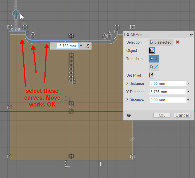

jeff_strater
I have been able to reproduce this problem.  It's a nice find, Luke.
This model has only side-to-side symmetry:
As long as I select only one side of the symmetry or the other, Move works OK:
However, if I select both sides of the symmetry, as in the screencast, I see the problem:
I will file this bug, and we can start fixing it.
