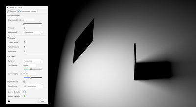

Did some more investigating. Here is a render with no environnement brightness using an emissive face only and "environnement" as background:
Now, same setup with "white" background:
Is this expected behaviour ?
I might have a wrong understanding of what it means to change the background ?
( btw, rendering this with transparent background gives the same result )
Can't I have a plain white background but still have the shadow rendered "as if" there was a ground plane. Isn't that the idea ?
