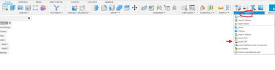

johnsonshiue
Hi! I guess there are many layers or the sketch geometry is massive. Try this and see if it works faster. Go to Insert section -> Insert DXF -> select an origin plane -> uncheck all layers except one. Does it work faster?

maple15207
I'm having trouble doing the above. Where is Insert Section?  Btw, Blender could not open the file either.
