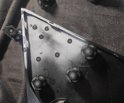

This is the part.
Next picture shows the part in position, but not already clamped in the B-Pillar cover because this is the trouble with this part. Once fixed, never can be unfixed without destroying. And Smart calls about 30 $ for this like breaker. Those white spots are remains of the scanner spray. Every scanner is in troube with black parts.

Here you can find a scan of the inner shape of the B-Pillar. As you said, the real shape is really essential for fit. It is a preliminary source for input. With your instructions i find a way! I am getting better and better, yeah!
