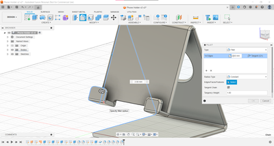

I cannot fillet my hook thingy, im new to fusion and ive tried like every fix none work, please help. I can share the .f3d if needed

Hi! Without seeing the actual model (f3d), it is very hard to understand why the fillet does not work. You may try a different fillet type. Suppress all existing fillets on the side edges. Try using Full Round Fillet. I believe it may create the desirable rounds more easily.

i added the f3d, take a look
TrippyLighting
I would make the 2mm fillets on the hooks slightly bigger than the wall thickness. That will solve all of the current filleting problems.

Fully define your sketches.
Make use of symmetry about the Origin.
Order of operations with Fillets can be critical.
Most Fillets should be Placed Features rather than Sketched Fillets.
