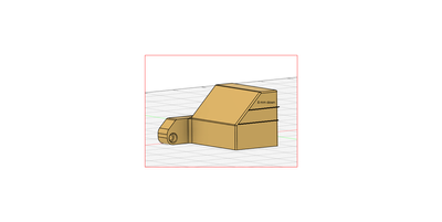

I am trying to add extrusion to an existing part.
It need to be placed a set distace from the top.
How do I measure down for placement?

Personally, I would create an Offset Plane from the Top of the Model (You can define the distance), then create a sketch of the feature that needs to be extruded. Extrude down toward the Top of the Model as Join.
Otherwise, can you export and share your model here so we can take a look at what you're trying?

Needs to be placed on the odd shapped edge 8mm down...

I need it a spec distance from the top. But I am unsure of the process...

Please mark the profile and the plane in which the extrusion should start

Your Sketch5 size and position is not fully defined.  You should fully define all geometry.
Sketch14 and 15 do not make logical sense.
Sketch16 is not fully defined.
Sketch24 is not fully defined.
Would you like to learn how to do all of this correctly with step-by-step instructions?
