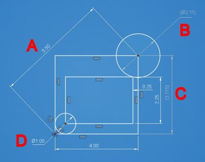

While I can appreciate the business case for leaving things the way they are, it becomes a matter of design intent. If the software could design everything for me, I would be out of a job. What I'm getting at is that when I sketch my geometry I dimension and constrain things the way that I expect them to react when I tweak the design.
Ex: If I adjust dimension "A" I know that "B" and "C" will change to fit but "D" will remain the same because of how I defined in relation to "A".These sketches are just your daily dose of random, they don't mean anything except to illustrate that I, as the designer want to be able to dimension my geometry so that it reacts to my changes. The reference dimensions are calculated values based on how I tweak the rest of the sketch.
If the problem is that is too complicated to program for real-time drag edits, then the functionality could be limited to what Fusion can concurrently solve without rebuilding the sketch similar to every other tool that has the ability to drag control points and edit dimensions. If you direct edit a fillet and make the radius too big, it stops the movement of the drag handle. Am I right?
