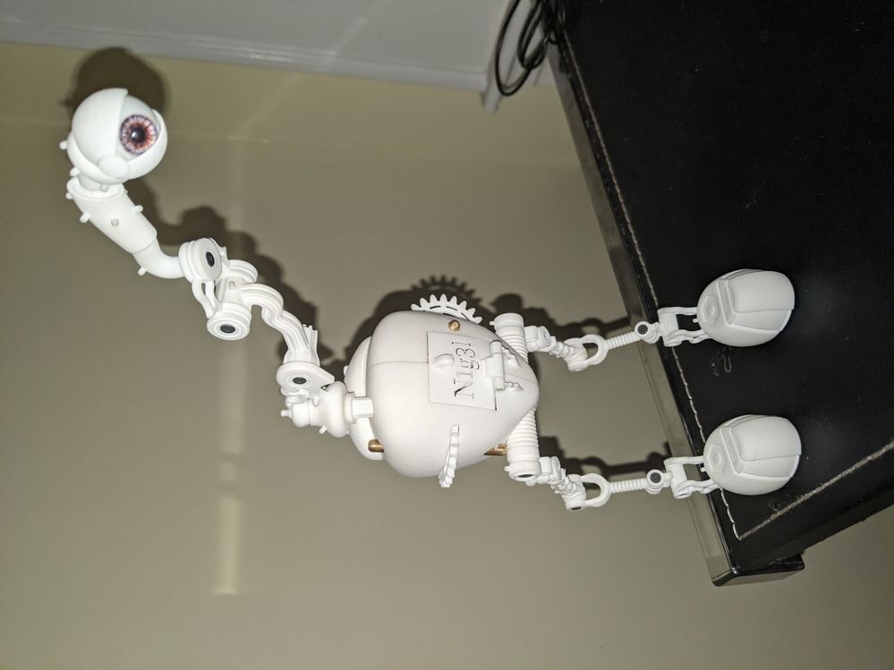

I printed!
Message 14 of 15
jeff_strater
that came out great!!
Jeff Strater
Engineering Director
Message 15 of 15
TrippyLighting
I agree with Jeff, that looks great!
