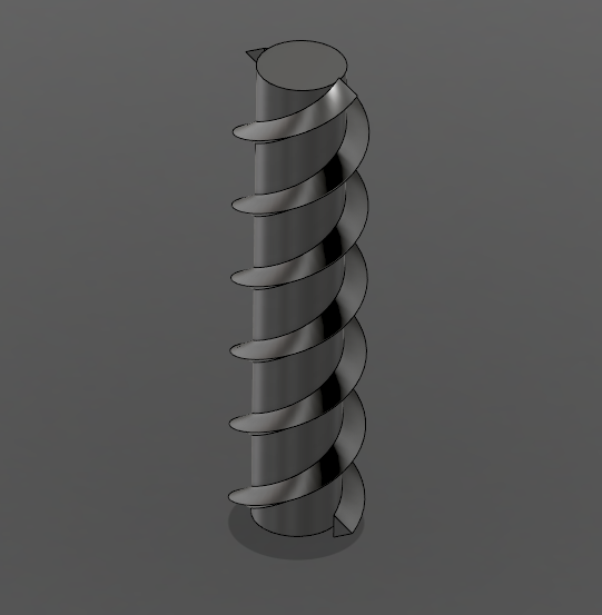

I did check, and verify that Fusion does not support this today.  You can try to emulate it using the Coil command, but the options that are available there are not ideal.  I made this using this method:
I can show you how I did this, but there are definite limitations to this method.
Jeff
