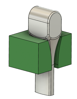

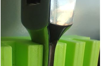

Where is a good starting place to learn how to mimic these compound curves in the attached image and surfaces and the tools and processes to do so?
Objective is to create a nesting shape to cradle the neck if this wrench.
I am using parametric design for the various sizes so if a parametric approach was feasible it would be great
TIA

to clarify, I'm looking to modify (fillet?) the sharp green edges to conform to the radius shapes of the wrench - where it transitions to the bulkier bock shape towards the top.

I am asking about conforming the sharp edges (red in images below) to conform to the multi faceted radii of the wrench (purple highlighted) - imagine the wrench being hot and being pulled into that slot melting the plastic to conform to the radii

Not sure how to do gusset/negative fillet

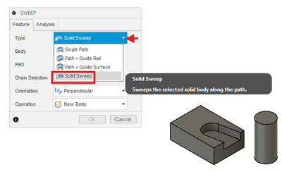

1. You can use Combine-Subtract of the wrench from the Holder (or you might need to pattern or Sweep (Solid body) if I understand your problem description).

Message 20 of 23
AndrewVanis
Thanks for this.  I have been working on this...could be a great solution!...There are several skills I have to practice to use this so thanks for the opportunity to learn these.
Would be nice to confirm before getting too far down this path....any reason I couldn't do the side way swipe demonstrated in your example first with the middle of the shank of the wrench to create the narrow slot  and then swipe down to recess the head?  The objective would be to have a couple of prongs?/some material to hold the head of the wrench from sliding forward when stored and then could be lifted up for removal.
