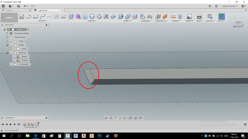

This might be a bug, check these pictures below, they are for the same part, but one 1 zoomed in and the other is zoomed out
As for the transitions at the corners, they are just fine
Saeed Hamza
Message 17 of 23
TrippyLighting
@SaeedHamza @jan.gladines
There's no bug 😉
Just set your design detail control to fixed/high and these visual artifacts are gone.

That means there is nothing wrong with the model, did you check it?
Saeed Hamza
Message 20 of 23
TrippyLighting
@SaeedHamza it removes tessellation artifacts. Fusion 360's LOD (level of detail) algorithm dynamically determines how fine to triangulter objects for viewing in the viewport.
Thats' the adaptive setting in that dialogue. However, for rendering one often needs to override this in oder to remove visible faceting. Particularly for objects with high aspect ratio e.g long and thin, or for shots with short focal length.
The design is fine and the twist control hande is where it should be.
