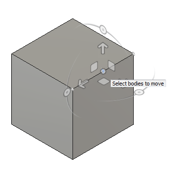

When using point to position move on a body, there are almost no snaps that appear. On a simple example with a box, the only snaps are the vertexes at the corners. Working with point to point move gives all the options I would expect and in fact more than usual, such as midpoint, center of face, etc., however this functionality is not there for point to position moves.

Hello derekmcleod,
Hmm... I'm not sure if that what you are looking for but I can indeed snap my moving anchor whenever you mentioned:
All you have to do is press "M" and then hoover over point you want to snap to.
Does it help?
Message 3 of 16
derekmcleod
That's the case for the Free Move and Point to Point move but not Point to Position. See below:mouseover-point-to-position-1.jpgmouseover-point-to-position-2.jpg

To achieve what you are looking for in point-to-position mode I had to generate manually additional points in places where I needed them. So in this example -  in the middle of the top plane and in the middle of the edge. Even they do not normally show directly from the Move menu, you can select them if they are created beforehand as new points.
I think this will party solve your problem, even it creates a little bit of extra work. Why they are not available straight away like in the rest of the modes? No clue, maybe we should report it as bug or idea?

Yeah, I found the same workaround. Had to create axes to arrive at the box face centerpoint to create a point. It can be done but would be great to have the functionality of the other move variants.
