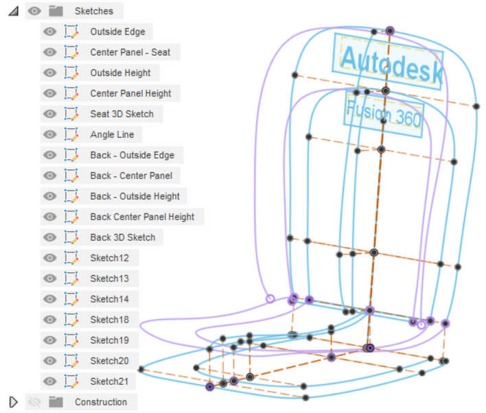

Back in the early days of Fusion 360 (June 2014)  - I posted a step-by-step tutorial for modeling the seat (from sketches rather than Form) for that toy car.
This was before constrained sketches...
But, if I edit my sketches from 2014, they show as fully constrained.
