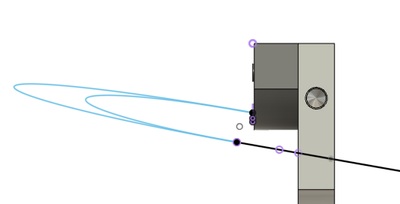

I'm trying to model a continuously down-sloping chute which does a 180 at both ends and after hours of making myself nuts, I'm calling in reinforcements.  Maybe it's something super easy that I've been unable to imagine.  I've tried using 3 point arcs which I can't get to continue the slope, and I've messed with splines and can't master controlling point movements enough.
Love to hear what approaches anyone can suggest.

Have you already tried the pipe command? You could create a single path, rather than the parallel paths, and then do a pipe. Then, put a plane where you want the rails to be and do an intersection curve or I think they call it a projection curve here in Fusion, and voilà.
I have modified your model, however the numbers I used are arbitrary.

Tip:  From my interpretation the ends are Helical with a slope section in between the two.

Two coils and a loft should fulfill the requirements:

True, but I think this will be 4 individual circular profiles, which, as @Fully_Defined has already mentioned, lends itself to the pipe tool.

Very interesting. I haven't used surface tools. Your process is all understandable except for how surfacetrim4 results in the two continuously sloping top edges on the right side. I see how the side view sketch contains the lines being following, but don't know how the operation follows them. Can you explain?

The path turns back on itself, so I split the body, vertically by origin plane.  May not be related to the trim.
The trim of the 2 open side bodies, had to be done separately from the half side body.
I still select the full path (cutter) in the vertical sketch, but I am only selecting the parts to remove.

In order to stay at the sensible abstraction level, draw any 2D curve/path. A fitted spline should give us reasonable flexibility, universality and manoeuvrability, as it can approximate any path.
Hence, how do we make our 2D curve sloppy?
  1. Think about it as a parametric function L(t) = L(x(t),y(t),z(t))
  2. We know x(t), y(t) functions; this is 2D curve
  3. We also know that δz/δs = const where δs = √ (1+δy²/ δx²)
  4. Thus transforming a 2D curve to a 3D one with a constant slope
  5. Requires integration of L(t) with condition δs(t) = const
  6. Scarryyyy,yes, it is.
  7. In a real/professional design scenario, quite serious number crunching is necessary.
  8. However, there is a piece of good news for ‘marble’ hobbyists
  9. Represent the path/curve as an equal segment polygon
  10. Change the z-coordinate of the successive point nodes by the constant slope value
  11. The number of segments will determine the precision of the operation
  12. hundreds??? … some people might find such a challenge … relaxing!
  13. For more ambitious … calculate forces acting on a hypothetical marble/car ball rolling along the path and translate z-nodes along respective vectors.
  14. For lazy&rich ones … buy professional software for road construction … from Autodesk.
  15. For optimists… ask TF360 to add such a feature to the Fusion suit.
Below, I am attaching the file showing the hobbyist part of the process.

Use my old file.  If having a go yourself, 1st step is written below, nearly forgot it.
Hide everything except the surface body.
This is step 2 - Surface > Create > Offset, select the ramp body from the Browser, drag the arrow up, enter the distance 0.275
Surface > Create > Ruled surface, select just the outside edges inside and outside, but not across the ends, (was fiddly to get it right). Set distance 0.286, and direction perpendicular.
Solid > Create > Pipe, select the same edges of each body, size 0.125.
I have not adjusted yet, because the pipe paths are slightly too short, go back to the first body,
Before anything else.
Surface > Create > Ruled surface, select the end short edges, and set them into the fixtures that exist
it’s not much, will allow the pipes to run into the buttons (to eliminate the slight birdsmouth.)
Set the direction Tangent
