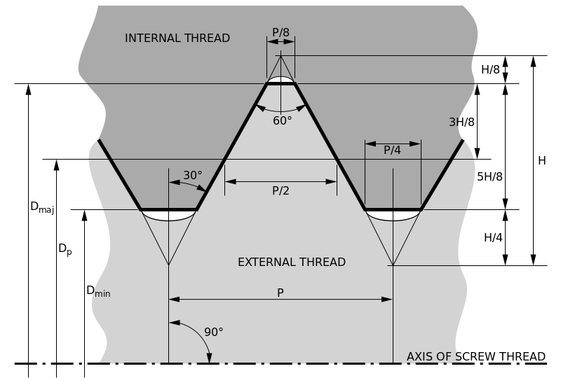

I'm pretty sure the metric thread forms are wrong. I'm making a mould tool to make M10 nuts. I've made a lot of unscrewing mould tools over the years and the thread on the OD of the core needs to be the same form as the ID of a nut (same form as a tap). When I section a female thread in Fusion the form looks all wrong, the ID and OD are correct for mid limits but the pitch diameter is wrong.
Here I've sketched the correct form using data from HERE, the section is a male thread made by Fusion.
Metric thread form. You can see here the thread should be more truncated at the core than at the OD.

The point I was really trying to make is the land at the top of the female thread is bigger than the the land on the ID on female threads Fusion is making. And you are correct the reason is because the pitch diameter is incorrect.
I found I could use Press Pull and offset the faces of the helical surfaces by 0.098mm to correct the problem for now. Looking at what I've ended up with Fusion's male threads look correct it's just the female ones that are wrong.

It looks like they've might have the P/8 and P/4 around the wrong way! 1.5/8 = 0.1875 and 1.5/4 =.375

I think you are right!  Those are reversed.

I think you are right as well. I logged FUS-30218 with our development team about this issue and will keep you updated as I have more information to share. Please let me know if you have any questions!

If it is indeed just a reversal of those two parameters, it should be a real quick fix.
