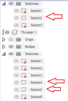

Are there any unresolved issues highlighted in your Timeline?

pavlos_kakouris
Thank you for replying! No unresolved issues in the timeline and all sketches fully defined. My instructor can't join.

TheCADWhisperer

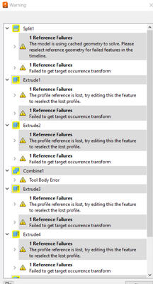

What are these yellow highlights?
Does Ctrl b (CMD b) return any issues?

pavlos_kakouris
Apologies, the unresolved issues in the model I uploaded are because it's a simplified model and I copy pasted the components from the actual model. I have attached a model with no issues and I am confident that the differences of the simplified model to the actual is not the problem since they're just some design details which I am not using in the joints formulation.
There are still some not fully defined sketches but I thought it was just good engineering practice, not a necessity that might interfere with the model. If it is and you think it will help solve the problem, then I will provide a model with fully defined sketches.

Message 11 of 16
TheCADWhisperer
Apologies, the unresolved issues in the model I uploaded are because…
There are still some not fully defined sketches but I thought it was just good engineering practice…
The unresolved Timeline issues and unconstrained sketches might not have anything to do with the motion problem, but when I ask a student (I taught for nearly 30 yrs) specifically about this and they tell me “doesn’t exist” I start to worry how many other “good engineering practices” they ignored and how deep I will have to dig to find the root cause.  This is why we have children cheering as they watch their super-heavy lift rocket, largest ever built, destroy itself along with launch pad. Some issues are hard to discover, but if we just ignore the obvious…

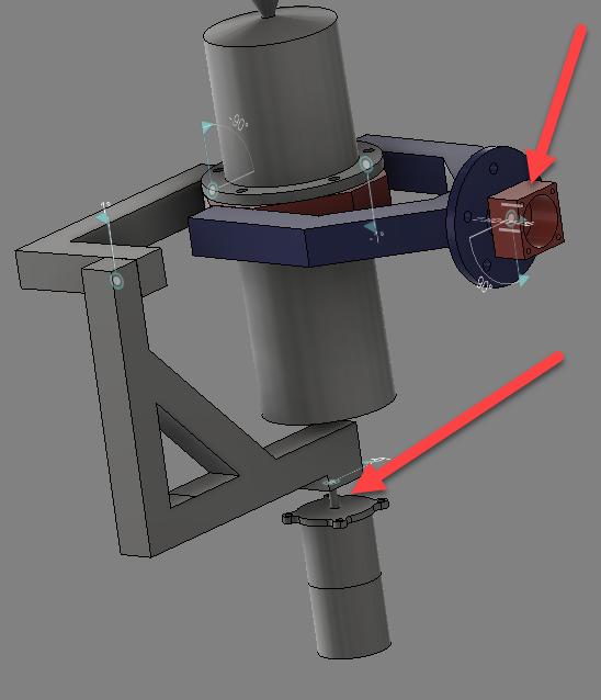

I can now see that you DID NOT misinterpret the YouTube video in your mechanism.  In the attached video I loosened up two of the joints using two cylindrical joints.  I then drive the motor my hand which show linear motion between the blue yoke and the fixed red mount.  I think this shows an incorrect length on one of the grey members.

jhackney1972
If you place Axis between your main members, it will reveal that you also have some alignment problems which could be related to dimensions issue mentioned in my last post.  Model attached.

davebYYPCU
The motor - not close enough.

pavlos_kakouris
@jhackney1972 @davebYYPCU Thank you both for your contributions and spending the time. The issue was indeed the misalignment of the axes. Thanks again!
