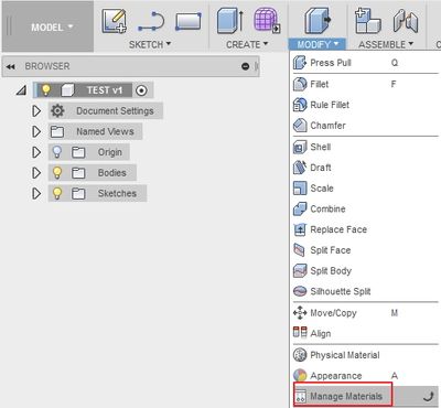

Would you mind trying it below?
1. Go to the "Manage materials" in the Modify tool bar.
2. Check the saved location (just hover the mouse cursor on the library name and it will showe the location)
I look forward your help
Many thanks ,
Ahreum.
