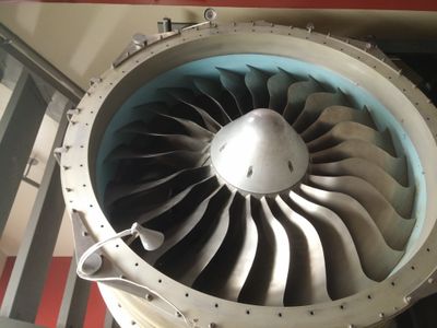

So i was at my friend's school and i saw this
Yea... I decided to build the same vent.
I'm still new to Fusion 360 but i pretty much know my way around stuff
and can design simple models.
I have tried to build this and i wouldn't have a problem in make this if it was flat
Notice how the blades are elevated/slanted on the sharp right edges(as to suck in air) during operation ? I don't know how to do that
I tried doing a simple scrap of this and this is how it turned out
Notice how mine is just simple,plain and flat ?? no creativity to it
Like as said, the drawing is not a problem but making the blade elevated is something i don't know how to do
I have tried using the conic curve but i used it wrong it just wasn't in tuned with the model
any help ??

This one is very basic, free hand if you like,
Cylinder hub, and a plane at angle, 45 degrees in this case,
2 d sketch for the blade shape, then Patched and thickened,
Circular pattern the blade.
Very quick and dirty conpared to the real world stuff, but will give you the basics....

If you right click any timeline icon, and select edit feature, the dialogue box I used will be there with all the settings in place,
Cancel or Ok, when you find what you were looking for. Step up and down doing that and you will see was done a bit better.
If stuck let me know...

Here is my approach, might help as well
