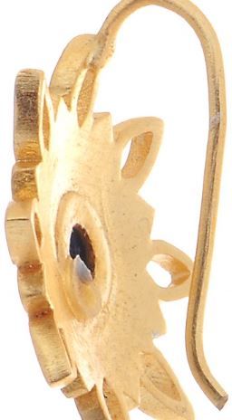

I have a problem in a certain file.
I have an object that I have created. It has been made from different bodies and has been joined together.
Its a flat looking object but I want to convert the object into a slightly curved object.
How can I do this?
I have attached a picture of the pc I made on fusion and the original pc I am trying to replicate.
Kindly help me with the same.
Thanks!
Ila

TheCADWhisperer
The easiest way would be to model in finished form.
Trim and Thicken spherical surfaces.

mufadal89
You can try this.
Take the outline of the profiles and make a sketch.
Project that sketch on to a curve surface , the curvature with which you want to have that part to be.
Then use the projected outlines to make your new part.
Message 8 of 10
Will try that out and let you know. Thanks so much!

Most of what you need is already in your model.
Roll the timeline back in the attached model, move it forward one step at a time and see if you can make sense of it.
This is the rendered end result:
Message 10 of 10
Hey this seems to be working!
Thanks so much!
