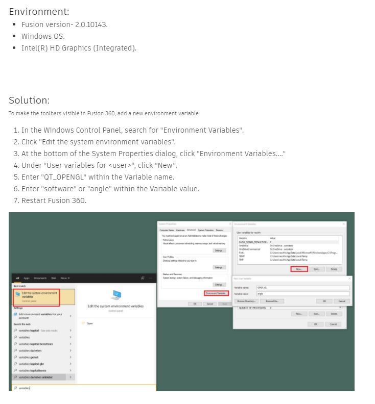

Yesterday everything with Fusion was fine. This morning, exactly the same hidden main menu problem described here except mine is blacked-out rather than whited-out (see below). As herein, I have tried all the suggested solutions and nothing has solved the problems. I have limped along (got classes to teach) by hovering the cursor until I hit the right box. Help, please!?!

@g-andresen Thank you! Found it: https://knowledge.autodesk.com/support/fusion-360/troubleshooting/caas/sfdcarticles/sfdcarticles/Too...
Best of all, it can be done at the user-level environmental variable, so my students won't need to bring their machines in so that IT can enter the admin mode. Instructions:

That environment variable fix seems to have worked!   Thank you a ton!  Not sure why this happened all of a sudden though, even after updating my graphics drivers/laptop firmware/etc, it was still not functioning.   I looked and there were no updates installed over the last couple days.  Super weird.
Either way, I'm back up and designing!  Thanks!
