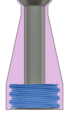

There shouldn't be anything wrong with the thread. Here's how it looks as-is:
and here it is with a 0.3mm offset on the internal thread:
It's important to perform the offsetting properly. I've added a link in my signature below to a guide I created on this subject.
If you can export your f3d file and post it here I can take a look at it.

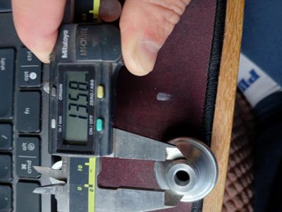

kris.chlapek
Ok, i think i know where the problem is.
I measure the current thread, and the top of the thread (major) is 14.85mm but the minor is 13.58m, so with the defualt this will need 13.5mm drill and change to the MinorDia to 13.55. Do i got it correctly you think?

Ok, thanks for the photos and the model. Here are a few observations:
  • When measuring the minor dia of the external thread with the calipers, are you getting right down into the root? If not then it will obviously show as being larger than it really is.
  • The general rule of thumb for a metric thread is that you subtract the pitch from the nominal (major) to arrive at the tapping drill size (i.e. the approximate minor dia). In this case 15-2.5 = 12.5. Are you sure this is a metric (i.e. 60°) 2.5mm pitch thread? Your 13.5mm measurement would suggest it's 1.5mm.
  • The partial xml that you've posted only has the minor diameter increased. Normal practice would be that you need to add the same amount to all three diameter values (the tapping drill value seems to be completely ignored by Fusion btw).
  • I didn't notice this earlier but the minor diameter in your edited xml is larger than the pitch diameter - In my experimentations I've found that Fusion doesn't like this and I'm not sure what it does to the thread thread profile in these cases.
  • A side-on view of the part might help determine what this thread is.

kris.chlapek
This is the problem that i have no idea what thread it is. Looks like it does not conform to anything i know.
It`s definetly 2.5mm pitch to pitch and 13.55 at the root.

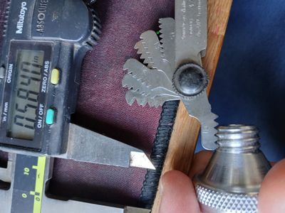

Thanks for the photo. Yes, from what I can see that doesn't look like a standard metric thread. My advice would be to leave the thread xml as I posted then start with offsetting the minor diameter of your nut such that it's larger than your measured external minor. This will remove any possibility that it's the minors that are interfering. As mentioned, Fusion doesn't like a minor dia larger than the pitch dia, hence the advice to do this with an offset in the model. If it still doesn't fit then start offsetting one of the flanks until it fits. You might need to offset the major as well, it depends how inaccurate the print is. From what I can see in your last photo this is the kind of result you're looking for (this has an offset of -0.6mm on the minor face only):

kris.chlapek
Hard to picture but i tried imperial thread gauge so pitch looks to be 10tpi but obviously is not deep enought to match and measure 0.584od
