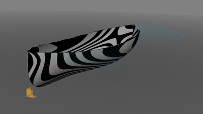

Hello folks, I am lofting a boat hull and this requires a 90 degree loft between the final two profiles to get the shape of the prow. I am struggling today to do this as part of one continuous loft and, because I've had this situation a few times (difficulty lofting perpendicular sketches) I thought I'd ask if anyone can explain why this is the case and how to do this successfully.
You'll see from the file that I'm able to do it in two lofts, so getting an end result isn't really the issue. I also know that I can do it if I leave a gap between the two sketches, but that creates some distortion to the keel edge. What I'm wanting to know is how to do it so I get exactly what I intend, every time, using this little boat as an example.

It's not the same boat but it's the same project, and the file at the point I attached it was 'roughing out', to check that the 'whole moulding' method of profile projection was giving me a satisfactory result. The pic below is the outcome of the original discussion. I'll be more than happy to be corrected Peter but I don't think my lazy constraining is causing the problem. This is probably a very bad habit to have got into but, when I have a lot of splines, arcs, tangential relationships and so on, I tend to just 'fix' the whole sketch when I'm happy with it, and the sketches are more constrained this afternoon than this morning. One time, and one time only, I manually constrained an entire spline and would never want to do that again.
I fully accept that the more profiles there are, the less likely it is that the surface will be 'fair', and less is better. I guess I could just use some of the profiles as rail guides. But what about this strange behaviour with respect to lofting perpendicular profiles? I don't understand why it will do the loft when it only has to join the two mating profiles, but not when I include the next profile along. I'm sure I've had instances where it just does it, as well as those where it won't, and I'd love to know what makes the difference.

TrippyLighting
The sketches in the model I have attached are not fully constrained, or dimensioned either . They simply have the "right" amount of constraints to be able to create a loft that also does not break when inputs are changed.
I used control point splines for this design.
I consider this design so far a good starting point.
This includes only three loft profiles. A (sketch)point on the front, one in the middle and one at the end.
You could now add two loft profiles, one on each side of the center if more control over the shape is needed.
This will degrade surface quality, but if done with care it should definitely be OK for a model.

TrippyLighting
No, actually I have not. I've only posted a design with a timeline, but that isn't self-explanatory.
For example I only use single-span control point splines, but I have not explained why.
@kevinwilcox46
A fit-point spline in Fusion 360 is a 5 degree multi-span non-uniform rational B-spline (NURBS) , a very complex mathematical object that consists of internal curve segments (spans) and definitions that keep the transitions between these spans smooth. See for example the section on B-Splines here.
A single span control point spline, on the other hand is mathematically equivalent to a Bezier spline and is inherently smooth. In Fusion 360, for large gentle curves it is also much easier to control than the fiddly tangent handles. That is particularly the case when you want to create 3D curves.
As it pertains to surface based workflows, that is the reason I prefer to work mostly with 3 and 5 degree single-span  curves. I use fit point splines mostly when In need to create a blend curve between two existing edges.
So that's curves. How about surfaces ?
Fusion 360 can import higher than 3-degree NURBS surfaces, but it can not crate them. Whatever curve you use in Fusion 360 for creating a surface, the surface will be a 3-degree surface.
For the bottom profile I needed to create a curve between two (straight) lines. I used a 5-degree curve with 6 control points. For a single span control point spline, the number of control point sis always one higher than the degree.
To achieve a smooth transition between the lines and the curve I applied  a continuity (G2) constraints.
There are no smooth surfaces without smooth curves and transitions! I also go through great lengths to keep any clutter out of sketches. For example I often use  the vertical/horizontal constraints to eliminate construction lines. That is purely personal preference, however.
When creating the top sketch, to ensure the rail start and end coincide exactly with the 1st sketch I projected 2 points as shown into the top sketch and used those as start and end points for the rail
The top rail is not a single span spline as I was not able to represent the shape well enough with only 6 control points. It has 7 control points.
Then I  surface-extruded the top profile from sketch one and trimmed it with the top rail. The resulting edge is very smooth:
In theory one could use an intersection curve, but the resulting curve has visible artifacts:
Then I created an offset plane and placed it somewhat in the center of the object. I then intersect-projected the upper surface and lower helper surface into the profile sketch to have precise points to constrain the 3-degree profile curve to.
Then I lofted, mirrored, stitched and shelled the object. I was surprised shelling worked as flawlessly as it did.
I am surprised, because lofting into a point is often a problem. Lofting creates NURBS surfaces. The shape of a NURBS surface is controlled by a 4-sided grid of control vertices (CVs) and associated weights. Lofting into a point will cause the control points of one side to collapse into that point. The weights will approach infinity and  the curvature of the surface will rapidly degrade, often causing problems with thickening, offsetting and shelling.
We got lucky this time.
