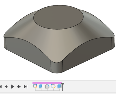

Brand new to fusion 360. Im trying to model this small camera for a drone and cant figure out how to loft the edges of these arched rails on the sides of the body to the top circle area? I basically want the all of the top edges to loft to the bottom of the circle above. Is this even possible? I keep getting the following error... "the selected rail does not touch all the profiles. Any tips?

Yes it can be done,
Loft rail errors come from white dots in sketches, that are undefined.
Might help....

Maybe something like the Attached (you should ALWAYS attach your actual file here)?
Keep Design for Manufacturability in mind when designing.
Loft is expensive, Revolve is cheap.
If you need Loft, you need Loft, just keep in mind that increases cost.

Yes, this is exactly what I'm looking for but I cannot seem to get it to work properly. I'm sure its some procedural error on my part but I'm at a loss. Attached is a similar example I made at the point where I get stuck.

Yes, I understand your solution and I got it to work your way but can I also do it in the way I was trying originally with the loft function and just lofting it along the top edges and to the bottom of the circle? Thanks for the help.

I didn't save my file, however the horizontal box fillet, makes the loft hard enough, but also leaves a crease on the red lines, due to the sharp corner change of direction.
Whisperer's simpler version has no crease, in these areas.

Loft is a different (more expensive) solution of more complex geometry.
Do you need Loft because my "solution" is not in fact what you want?

Yes, you probably can, but that doesn't make it a good idea. The quality of the surface will be terrible and difficult to manufacture with traditional (CAM) methods.
Even of you 3D print it and surface complexity is mostly free, you will likely see undesirable surface artifacts because, again, the surface will be terrible.

In some cases a Loft will create primitive planar, cylindrical, or conical faces - but in most cases Loft is more of "freeform" tool.  Think art sculpture.  It takes a particular skill to create aesthetically pleasing art sculpture.  Most people do not have that skill.  And those that do have often spent years developing that skill.  Those that don't create rubbish when attempting to create sculpture.  (It might look sort of good from a distance, but when you get up closer you see the flaws.)  Think of an autobody paint job where the bondo edges show through the paint.  Bottom line - get 6mths to 6yrs experience under your belt before attempting Loft.
If you are observant - you should notice that these corners in my "solution" are completely different your setup...
My "solution" droops down here (that is a artsy term). Ahhh, where are the emojis...
