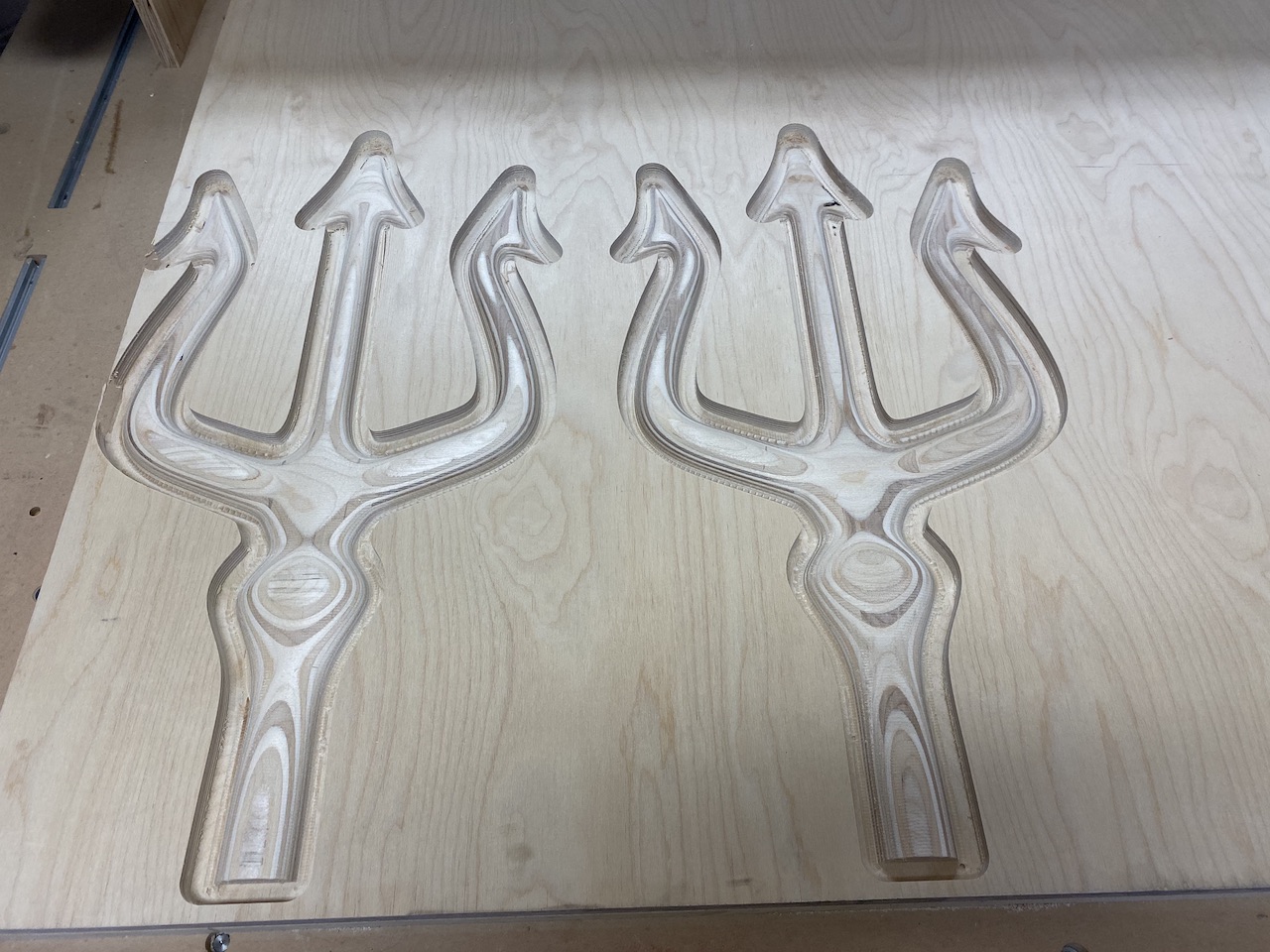

  I am helping out with a school play and trying to model a trident to cut on my CNC router.  I am not sure how to model this part.  Basically I want to create a half round profile of the sketch and will cut two and stick together (easier to machine).  I am comfortable with solid modeling and CAM in fusion, but haven't done much in the surface space.  I have attempted variations of loft and sweep, but to no avail.  I have tried searching the forums, but not even sure what I am looking for..  Any help or pointers would be much appreciated.

@laughingcreek sorry.. forgot to post these after the play.  I ended up tweaking your design slightly, but it gave me a great start!  Appreciate the help. I machined as two halves to make it easier (no front-back registration..).
I actually had to make it twice.  First one I made out of some scrap MDF I had lying around, but it broke opening night on stage..  Second one I made out of 3/4" Baltic Birch.  Totally solid.
In full disclosure, I was King Triton, my daughter was Prince Eric in the picture next to me.
