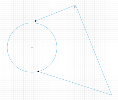

@conjured2018 wrote:
 On tangent, I do not understand how to make the rails tangent.
What is this all about? Dimensions?
What are the lines for?
Is this the curve that you really want?
What are these lines for?
Where are the logical dimensions?
Design Intent?
Do you have examples of prior projects of increasing complexity that you completed leading up to this project?

attached is earlier trans version.Please note that this one has straight edges. My attempt in new version is to round off these edges to make loft smoother. This has worked yet I have on area I can not fix. This area, top right in original upload will not take rails. I get rails do not touch profiles area.
And I have tried to tangent the points you showed but it makes sketch unusable. I just used the body as template for sketch.
How do I dimension this multi curved body?

conjured2018
I went back to sketch and fixed the 2 areas, I was successful in moving a point around and then doing tangent. Body is now smooth. Thanks, JR
