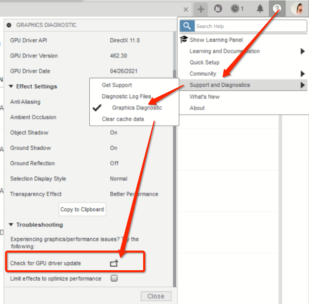

Hello,  I am using fusion 360 educational licence. I am working on drawing environment, but all of the lines are not visible (the model lines, border lines, dimension lines, etc). I tried to change the style and edge visibility, but they did not working at all. I also tried to reinstall the application incase there is some error, but it didn't solve my problem.
The selected one on the image above is the drawing of my 3d model. As you can see, the lines are not seen.
All of the lines are visible only when I export the drawing to PDF file.

Take a look at this thread and the offered solutions.
John Hackney, Retired
ClintBrown3D
Hi @Anonymous
This issue is solved by updating your graphics driver. As @jhackney1972 has pointed out, that thread shows the same issue and a graphics driver resolving the issue.
We suggest that you download and install the latest graphics driver from your graphics card manufacture. There is some guidance for updating your graphics driver here: https://knowledge.autodesk.com/support/fusion-360/troubleshooting/caas/sfdcarticles/sfdcarticles/How-to-update-graphics-driver-for-Fusion-360-in-Windows.html

I am having the same issue but my graphics are up to date and I have also tried the open GL core profile with no luck
ClintBrown3D
Hi @ryan_kirkN5LME
Open GL setting will not help you here. This issue is specific to your graphics card driver. Windows updates have been rolling back certain AMD drivers.
Please download the correct driver for your PC from the card manufacturers website.
