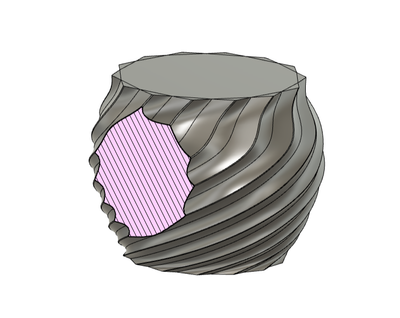

Hey everyone,
I am fairly new to Fusion360. After revolving the inside of a plant pot I am designing, the sketch line is imprinted into my object, and it will show when 3D printing. I attempted everything I have seen online but that simply won't go. Any suggestions would be greatly appreciated. The line in question is the sole black line on the inside of the pot.
Thank you in advance.

Just print this solid in spiralvase and see what happens.
Message 25 of 25
TheCADWhisperer
@olafserdmann
You can avoid that curve by using tangent lines/arcs rather than Spline in your Revolve profile.
If you want Spline then you will have to Save as Mesh (not Export) as high resolution and then Remesh.  Did you figure all this out?
