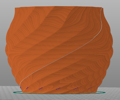

Hey everyone,
I am fairly new to Fusion360. After revolving the inside of a plant pot I am designing, the sketch line is imprinted into my object, and it will show when 3D printing. I attempted everything I have seen online but that simply won't go. Any suggestions would be greatly appreciated. The line in question is the sole black line on the inside of the pot.
Thank you in advance.

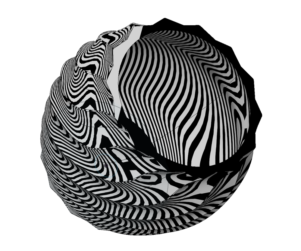

That "line" is a model edge that is required for the mathematics of a complex revolved surface.  It should not cause any harm - the surface will still be continuous across that edge.  If it bothers you visually, turn off edge display, by setting your visual style to "Shaded":

Yes, talking about a 3D print. You can believe whatever you want, it prints it, and it show it on the slicing software. I will share the file here shortly under @TheCADWhisperer's comment.

here is what I see when I apply analyses to this face:  This looks completely continuous across that edge:
Screenshot 2023-12-12 at 5.17.29 PM.pngScreenshot 2023-12-12 at 5.18.01 PM.png

but it isn't, the line is still there. I posted a couple pics of a sample print
Message 14 of 25
jeff_strater
Thanks for the photos.  Yes, there is a line there.  But, I notice that the seam is also on the outside of the body.  So, I don't think it is related to the revolve feature on the inside cavity of the body.  It could be a slicer problem, or maybe a mesh export problem - can you try exporting the mesh with a higher resolution?

wersy
Which slicer are you using?
If seam is set to aligned, this seam will result.

Even if various registers are now pulled in Fusion, there is no getting around designing the z seam in the slicer appropriately.
