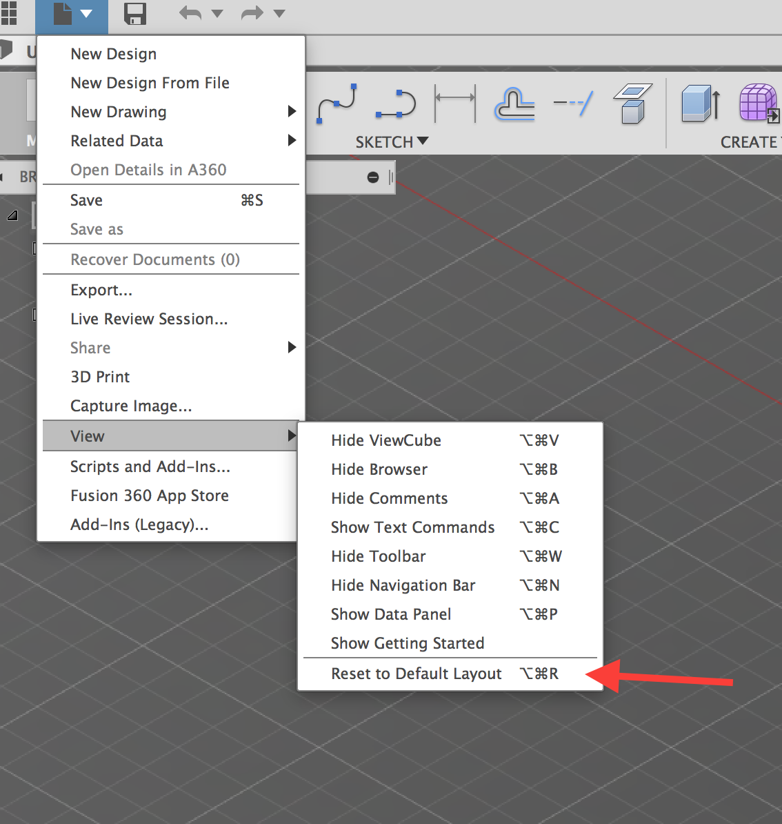

I have one more thing for you to try - your UI appears to be customized. Could you reset your layout, by going to file menu->view>Reset to Default Layout,?

LMD001
@cekuhnen
Hello Claas,
Reset to default layout:
Best regards,
Ludo
