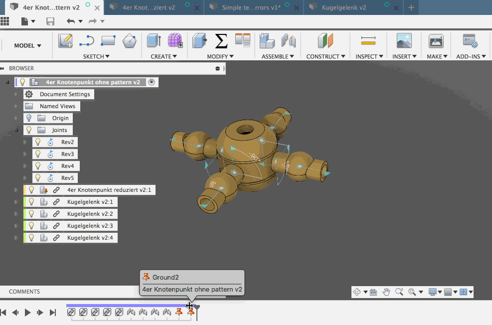

Message 12 of 21
Here is the link to the test design from the screencast.
https://a360.co/2MkxXbQ
Message 13 of 21
TrippyLighting
@pawel.potyrala You might want to record this behavior in the viewport as a bug.
If you move the timeline marker back to before the 2 grounding operations and drag the 4er Kontenpunkt Reduzier around in the viewport, the revolute joint symbols, which belong to the linked Kugelgelenk component, remain in place.
If you grind the part (and capture the position) and move drag around on the parts the symbols jump back not position and it seems the whole assembly still works, but this is still a bug!

TrippyLighting
@Anonymous When working in assemblies with such large degrees of freedom, you have to be very, very, V.E.R.Y careful with what is joined to what, so what you consider to be the stationary component, when creating the joint, should actually be the second component selects in the joint creation dialogue.
Then it probably helps not only to define joint limits, but also rest positions somewhat close to the final orientation of the part. This will avoid having to use the position capture feature.
I believe when using the position capture feature I see another bug or two. Holy Crap!
