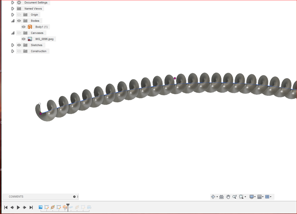

davebYYPCU
Two step process,
Sweep with twist to find the centre line of a,
Pipe with adjusted thickness to your liking.

davebYYPCU
There are a few ways to do it, I use pipe for the reduction in sketching.
Pipe is the twisted coil in that picture, changing its diameter is quick and easier than adjusting a Sweep profile sketch dimension in some cases.
Back shortly with some pics to explain.

Message 7 of 28
davebYYPCU
Construct the centre line with Twist Sweep of a line in the Patch Area.
Add Pipe, so that there is no overlap / self intersection,
Revolve the casing,
Step up the timeline....

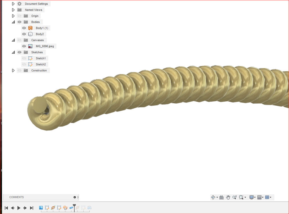

etfrench
Yet another way would be using Pattern on Path.
Create the path using a sketch.
Create a Plane on path with Distance set to 0.
Create a torus(donut) at the plane angled at the pitch of the twist.
Use Pattern of Path to finish the twist portion of the model.
ETFrench
Message 9 of 28
g.isley
Thanks,  The torus idea work great.  It allowed me more degrees fo freedom to customize my design.

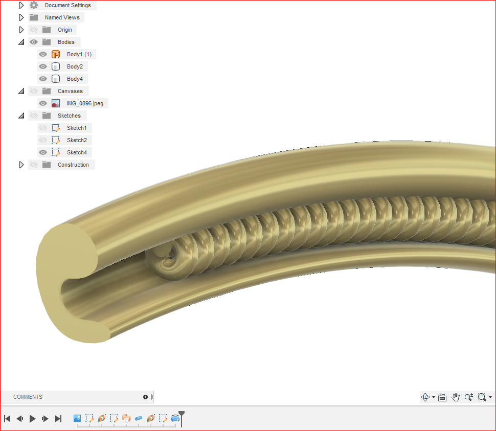

Message 13 of 28
etfrench
You just need to reduce the size of the pipe to .3mm or smaller.  The ring on the left is what it will look like. The right hand one is with a torus.
You may want to check the size of this as the diameter is only 3.5mm.

davebYYPCU
@etfrench  My example was Sweep Twisted, and Pipe.  Your sweep needs more revolutions and smaller diameter pipe, without being critical.
@g.isley  At the time, I had no idea of the size for the canvass, I mention having to adjust for self intersection.  So I bought the canvass in at 10 times bigger than default.  The pipe would do 7mm but not 7.5mm, looked ok, - as an example.
At life size things may still need adjusting, more Sweep revs, less pipe diameter.
