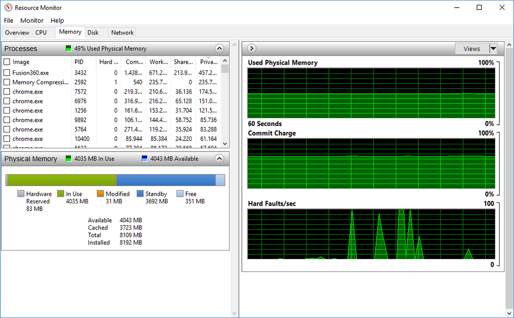

@Anonymous, will you please take a screenshot of the Task Manager Processes tab (Please arrange the table by CPU usage)? We need to see the CPU % that Fusion 360 takes!
We also need to see if all the CPU's are been used (Click on the Performance Tab and on the bottom you will see Open Resource Monitor. We need to see The CPU tab and the Memory tab)!
Like this:
