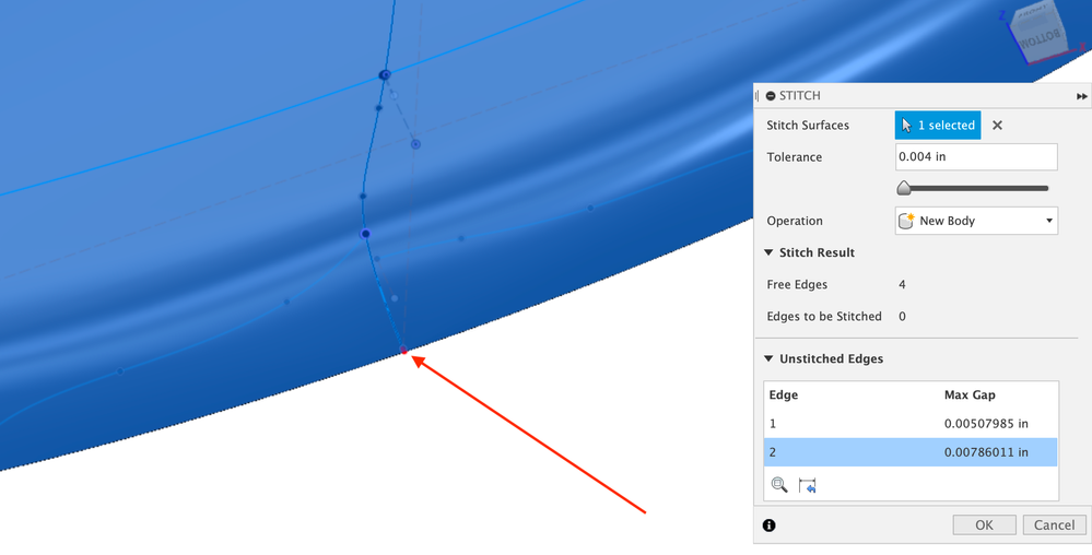

I have this guitar body made from lofting. I had patched and stitched the body and it only shows one body in the menu, but it is behaving like there are more than one and that the stitch did not work (in section analysis the body is still just 2d surfaces).

I don't have time right now to dig into the design, but the Stitch command itself shows where the problems are.  You have one on each end of the body.
On the neck end:
zooming in:
On the other end, same thing:
again, zooming in:
so, find the features that caused those openings.  If you can identify which specific feature caused this, it will help others to help you.

davebYYPCU
Easy to find, Jeff, Sketch 4 is not connected to the other sketches and is wide open, the loft shrinkwrapping has opened the gap.

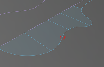

I have attempted to redo the entire file (geometry was too weird to patch in those two small gaps), and this time I can't figure out what is causing this loft on the right side to fail (it will not loft to the profile on the Y axis, it only lofts "flat" to the centerline when I select the curved face of the other side to be the last portion of the loft.
How do I go about trouble shooting lofts made with splines?

I was able to create one half of the loft by creating two ruled surfaces.  I then delete the ruled surface in the middle and try to create the loft on the other side but it doesn't recognize the loft edge in the center.

davebYYPCU
If you Delete the Ruled surface, you also delete the 1st Loft.  Use Remove, or just hide it.
You made a ruled surface to avoid using the sketch, so hide the sketches for 2nd Loft.
you have Rails? Connecting to the Centre Datum Line by the look of it, only one vertical Rail sketch?  You have a Outline Surface on that side too, right?
Might help....
