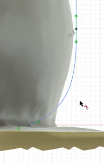

cekuhnen
making a spline G1 to a line works well when later adjusting the spline
Screen Shot 2019-08-01 at 9.49.13 AM.pngScreen Shot 2019-08-01 at 9.50.40 AM.png
When however you use G2 the spline shape radically changes after the other spline end point will be moved.
From a usability stand point this makes somewhat zero sense.
Screen Shot 2019-08-01 at 9.49.28 AM.pngScreen Shot 2019-08-01 at 9.49.44 AM.png
So what is happening here internally that makes Fusion change the G2 result so drastically.
I never saw this in any other CAD app.

TrippyLighting
This was easy to reproduce and I'd say that's a bug.

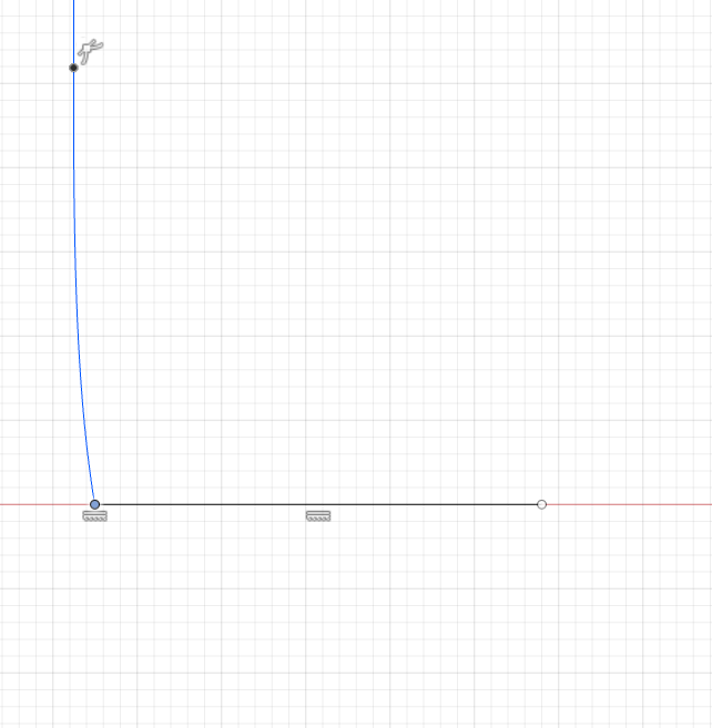

cekuhnen
Hi Jeff
here is the file - it seems this is related to when the tangent handles are not activated.
anyway - did I say sketching in Fusion is a pain ? ...
Screen Shot 2019-08-01 at 11.27.02 AM.pngScreen Shot 2019-08-01 at 11.27.06 AM.png

jeff_strater
Thanks, @cekuhnen & @TrippyLighting .  That's what I needed.  I'll have the sketch team look into it.
[edit] I created FUS-52818 to track this
