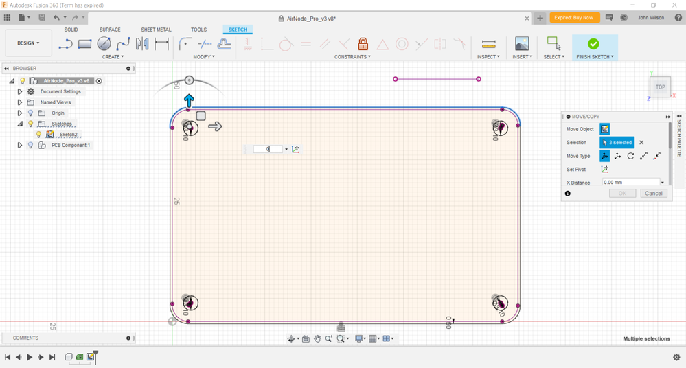

So I projected the board outline and 4 mounting holes into a new sketch.  I made the holes construction lines and created new offset circles.  And I did a .5mm offset of the board outline to allow breathing room and I'm now trying to move the top line + 2 side curves to allow space for the wifi antenna before extruding and shelling.  I cannot get these things to move.  What am I doing wrong now?

They are part of an offset so fully constrained, you can't move just part of an offset. Think I'd just draw a rectangle around the projected edges and dimension the offsets for each side. Keep the corners sharp and use Fillet on the 3d model after extruding.

First, you Projected in the edge of the board. That gave you the purple outline, which means it's a linked projection. Then, you selected that entire purple outline and did an Offset of it 0.5mm.
So you can't just Move the purple stuff, because it's linked. And you can't just Move any of the outer edge because it's defined by that 0.5mm Offset value.
#1. Stop trying to use the Move tool on sketch elements. Instead, set things up properly with dimensions, and when you want to change the position of something, double click and edit the appropriate dimension value.
#2. In order to do that with your top edge and the two fillets, you will need to delete the existing outer edge you created with Offset, and Offset the bottom and three sides as a single Offset. Then use Lines and arcs to draw the upper portion, constrain it appropriately, and dimension that top line away from the purple projected line the desired distance. In this way, you will have one Offset value assigned to the bottom and two sides, but a separate dimensioned value for the top, which can be adjusted/edited separately from the Offset value that the other sides have.
#3. It might be easier just to draw a rectangle around the purple projected one, and then dimensions the four sides from the purple projected sides independently. Then you could change the distance of any side alone, or in combinations, or whatever.
