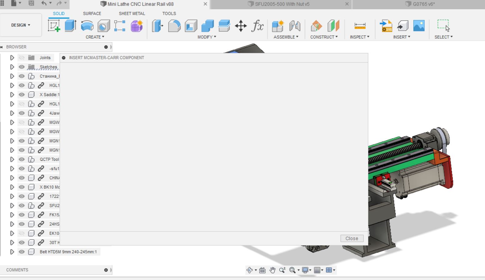

Hello!
I have tried to look online but did not find anyone else complaning about it, so I am afraid for some reason I am the only one.
Since a week I can not open the McMaster cart. I have attached a picture to show what I see.
Any thoughts?
Thank you.
Best,
Alessio

Just something to try, go to your Preferences and switch to the OpenGL setting.  Fusion 360 will have to restart so please make sure you have saved any files you have open.

No unfortunately it doesn't solve the issue but thank you for your help

I have tried on Mac and it does work. So for the moment it is confined to my Windows laptop. I should try with the tower pc that is Windows too. Not sure what could be the problem if it is the pc.
Message 5 of 24
HughesTooling
Have you got the latest update? Should be version 2.0.10032

Yes I do. I am now trying with a fresh reinstall.

Just finished to reinstall it. PRoblem stil lthere. I have no idea!
Message 8 of 24
alessiol
So actually also Insert > Insert TraceParts Supplier Components is not working. It shows the same empty window as Insert McMaster carr. They do have the same layout window so probably they are not working for the same reason.
I have so many bolts to add! 🙂
Message 9 of 24
HughesTooling
Works OK for me on Windows. When you did the uninstall did you use the clean uninstall tool? not sure it will make a difference but it does remove all Fusion info.

Did the clean unistal and installed it back...
well got even worse. Now when I open Fusion360 this is what I see!
Message 12 of 24
HughesTooling
There's not a sign in dialog hidden behind the window is there? Do you have any problems viewing your hub in a browser?

No, there is anything hidden behind it 😞 Usually that is the point where you have the first log in with username and password.
Yes I can see all my projects online without any problem.

I guess try the clean uninstall again but after uninstall reboot your PC before the reinstall. Might also be worth rebooting your router as well.
Edit. After rebooting your computer make sure Windows is up to date before reinstalling Fusion. There was someone the other day with problems and Windows had an update pending.

Nothing. Windows is now completely updated. I unistalled Fusion again like 3 times, and removed all the possible folders connect to it. Reboot. Once I reinstall Fusion I still have the same problem. Empty window like before.
I was wondering. Is it possible to open a assistance ticket so that I get the attention of someone from Autodesk?
