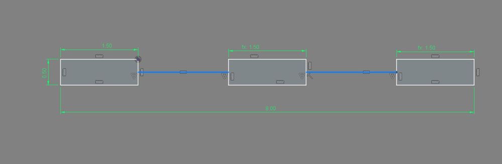

How about you don't use rectangular pattern, but create each rectangle manually.
In my sketch below, the 2 lines highlighted in blue have an equal constraint, and are driven by the other dimensions?
