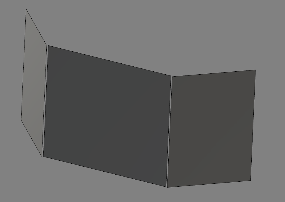

Here's an exaggerated view of what is happening.  Here are some faces that have gaps between them:
And here is my interpretation of what happens when you stitch those faces with a large tolerance.  The red tubes are the tolerant edges.  But, the faces have not changed at all:

Hope this helps clear up what is going on.  The real problem is in the source data for this model.  It's pretty inexact, is my guess.
