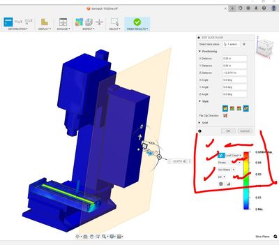

Section analysis should be the same fuctionality as "Extrude Cut".  It would be nice to be able to select what bodies can be sectioned in a view.
It would be nice to also be able to select which bodies are section when evaluating simulation results.
Below can be seen the fuctionality of the three section operations.
  • Extrude cut where the bodies can be activated or not for the operation
  • Next is the Section Analysis without the ability to activate/de-activate bodies
  • Last is the FEA Results analysis where selection of a body functionality is not available either
