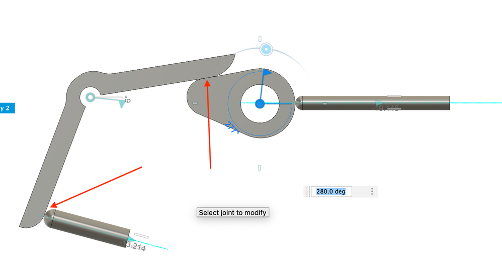

jeff_strater
It seems to work pretty well with Drive Joint and Animate Model.  Yes, there is a bit of a hitch here:
But, really, it is not too bad, IMO.  I am not sure whether this hitch is caused because the tangent relationship is really plane-on-plane at this point, or, because it also happens to be where the contact set is engaged, and contact sets are very compute intensive.

@jeff_strater The reason there is a hitch is intentional. This hitch is happening because the Tangent Relationship for that cam pieces goes all the way around. It's tagged to the side face. It's flat all around. But, the Tangent Face on the lobe only provides contact to the cam about 99 percent through that turn. That's why that face has a single side fillet. Once it goes outside of that designated fillet zone it slips out. And also the reason the mechanism only works in one direction. You can try to reverse the Clockwise Chainstey Joint. But, you'll find it almost impossible. It's a as-built joint. I have a lot of trouble making Joints and snapping them in the place for some reason.

Component Drag is a slightly different operation than either Drive Joint or Animate Model.  Sometimes, in order to try to get "preferred" behavior during component drag, additional, hidden constraints are applied to the model, which can result in different behaviors than Drive or Animate.  I would not recommend using component drag, in general.
