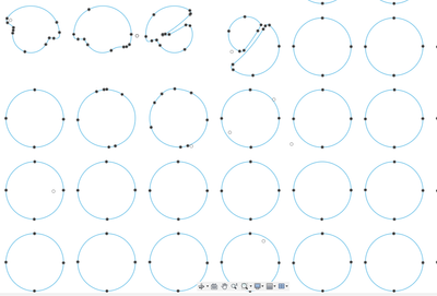

Hi,  I have a customer who provided me an .ai file.  In AI the circles are complete.   When i save as .dxf and import into fusion the circles are not closed.  Can't extrude them.  Any idea how to fix this or how to export properly?  I have attached a picture showing what im talking about.  They are a complete circle but not connected to create a sealed circle.  Thanks

Can you share the Illustrator file?
davebYYPCU
Edit Sketch, Check that the Show Profile option is ticked.
Window select all, and move to sketch plane if that option exists in the right click menu.
Circles don’t have boundary points,
Imported geometry is a time soak.
Might help….
It does not look like there is a single arc or circle in the sketch you attached. Looks like all splines in the sketch so whatever program you're using to convert the ai file is either not doing a good job or the ai has no arcs in it. Can you share the ai file?
Probably best to create a new sketch and use the import as a reference and create 3 point circles in Fusion. Not going to be a good idea to extrude the spline to create bodies directly as it will create more complex geometry than simple arcs will.
When creating the new sketch in Fusion be careful to only click on the points so you don't get the splines projected into the sketch as you create the circles.
